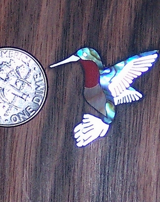

Well as some know i am way behind on a classical commission for a client. but I thought I would stop and give a peak at on of two micro size humming birds going in teh rosette on this classical. These are the smallest mulit piece gritters I have ever done.

Well as some know I am way behind on a classical commission for a client. but I thought I would stop and give a peak at on of two micro size humming birds going in the rosette on this classical. These are the smallest multi piece critters I have ever done.

I use an unusual scribing technique. being an Old shutter bug and having a bunch of 35mm black/ white film around and access to a dark room I glued together the 11 pieces together with CA after assembling them on a piece of double sided tape. Once the CA was good and cured I removed the assembled piece from the tape. took it to the dark room and laid it on a piece of undeveloped film. and then exposed it to a light source perpendicular to the film to avoid shadowing. this took a couple attempts.
Once I got a good shot and developed the negative I was left with the a clear patch where the inlay sat. Then again use clear double sided tape taped the negative in place. and using a #5 exacto carefully scribed the pattern.
While I could have glued the inlay piece to the wood and scribed around it with less over all process required. I was worried about the fragility of the feathered areas while scribing as they are cut lines not scribed lines. and thought if this template method would produce a better template than drawing or photocopying could. and it worked like a charm.
This process would not be for everyone but is just an example of outside the box thinking can help solve problems.

The back of the bodies are Paua, the throat is recon corral, the breast is bronze MOP, The beak and eye are gold MOP and of course the wing and tail feathers are white MOP.

Very nice! Nicely fitted pieces and good lines for the feathers; It only takes one wrong cut to mess up those dang feathers!!!

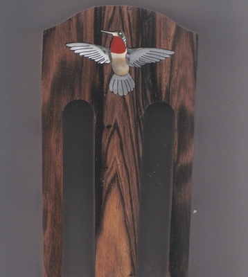

Michael I hope the colors look right. viewing the post on my computer here at work the colors are muted and kind of brownish but on my computer at home the pictures a clear and bright. like I aid the breast is made from bronze MOP hand has the typical faint rainbow effect common in bronze MOP but it does not show up on this computer at all but dose at home. The throat is really a bright red corral it look dark dull on this computer. This computer has an ultra high end 128 bit graphics card for High res 3d rendering work. I fear it may be going bad. but if the pictures, in particular the peghead is hazy dull to you guys. Let me know would you?

Michael I hope the colors look right. Viewing the post on my computer here at work the colors are muted and kind of brownish, but on my computer at home the pictures are clear and bright. like I said the breast is made from bronze MOP hand has the typical faint rainbow effect common in bronze MOP but it does not show up on this computer at all but dose at home. The throat is really a bright red corral it look dark dull on this computer. This computer has an ultra high end 128 bit graphics card for High res 3d rendering work. I fear it may be going bad. But if the pictures, in particular the peghead, are hazy dull to you guys. Let me know would you?

The headstock inlay indeed has a bright red throat on this display, but on the rosette it's brownish. Could be the way your camera was reading the light. It's difficult to get the 3-D effect of pearl to show up in a photo, especially one that has to have lower resolution for the web.

tje bronze is not showing up real well but the other colours are great. it's a success, believe me.
